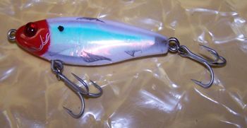

One of my favorite lures that I won't replace until I have to
This is one of my favorite lures to throw and, up until I saw that fishing show, I never thought twice about slinging this thing by my head, time after time. It's a $6 lure, so I'm not crazy about replacing the entire lure if I don't have to.

I'm lucky in the fact that I really enjoy using L&S MirroLures, and these lures are built about 15 minutes from my house. So, a phone call is all it takes to get new lures (sometimes before stores get them) and replacement parts. I made the call, took the drive, picked up some replacement hooks and "O" rings. Once I got them home, I couldn't resist the before-after picture.
Couldn't resist the Before-and-After
I removed that one hook for the photo-op by opening the "O" ring and sliding it around, but for the rest of the hooks I simply cut them off at the eye. The hook replacement process is something I'm sure you're already familiar with, so I won't bore you with that. Just be careful, because you don't want to be doing that "fish hook removal hand" internet search out of necessity.
I actually replaced hooks on a number of lures while I was at it. After removing the old hooks, I took the lures in the house and gave them a scrub. They looked good as new. I didn't replace the "O" rings because they didn't look too bad, and because my cheapo "O" ring pliers made it difficult. However, the finished product turned out pretty nice.
