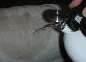

A safe way to apply heat, although it takes many applications, is to pour boiling water over --- not the boat directly --- a layer of towels (3-4 thicknesses) laid directly over the depressed area. The towels spread out and slightly muffle the heat of the boiling water and gradually softens the plastic to a point it can be persuaded back into shape.
The towels should cover the entire area to be "massaged" and a blunt stick (broom handle?) can be used to encourage smaller areas back to shape. The process of pouring hot water over the boat is repeated many times until the hardness of the plastic deck or hull begins to yield to the heat. Sometimes you have to move the towels around for the best heat distribution – trial and error.
I once took delivery of a damaged-in-transit kayak and brought it back to salable form. It had eight inches of the bow shoved back in on itself (probably pressed against an exposed bolt or rod in the storage bin). It looked like a pig snout. It took about six gallons of boiling water and two hours of gentle stroking with a broom handle, but it worked!
