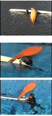

The bow lift is one of the basic options. You can use your paddle float when it is on the paddle and put the paddle shaft under your armpit with the float close to your body. When ready, do strong scissors kicks and lift the bow. You may need to bounce the kayak to break the seal at the cockpit coaming.
Once the bow is lifted, hold it up as long as you can to drain more water. When ready try to spin the kayak right side up. Some kayaks spin up automatically.
Strength and arm length are a great asset but I have a 5 ft tall friend who can do this with just a quick lift and flip with her kayak.
There are some kayaks I cannot lift by the nature of their design. There are other kayaks I can lift without the use of the float thanks to their design and my longer arms and strength. It is very difficult or impossible to do this with a loaded kayak or a kayak without a rear bulkhead.
