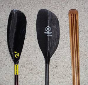

I decided to test three different paddles
I decided to test different paddles under similar conditions. I tried to control the major factors. I used the same kayak. I paddled the same route using a GPS and my stopwatch. My route was 1.25 miles long (one lap around the lake). I would paddle four &/or five laps around the lake per workout. I would change my paddle after each lap. On each training day I changed the order of use of each paddle. The two factors I could not control were the wind and my energy levels. I figured if I were the common denominator with the same kayak I would see a trend in performance results from the different paddles.

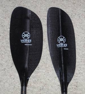

I decided to compare three different paddles. My Tuktu Greenland paddle (Tuktu eight feet long x 3 & 3/8" wide), my big blade paddle (Werner Corryvrecken) and my wing paddle (Epic mid size wing). I felt these three paddles would give me a great comparison since they represent three different styles of blade. The narrow Greenland blade, the wide blade euro-paddle and the racing blade give a fair representation of the different blade styles. As a side note, I have previously determined that my top speed with a euro-paddle was with my wide blade paddle compared to two different euro-paddles with narrower blades.
I paddled at least three days a week, for a couple of months, recording my comparisons. Again, I rotated the order of my paddle use so each paddle would be used on different legs of the training day. On a few days I did two laps per trial instead of one. My measurements were simple. I had a fixed distance, confirmed by my GPS. Rather than trust the GPS rate indicator, I divided the distance by my lap time gathered from my stopwatch. This gave me a more precise paddling speed.
Plotting My Results
I plotted the results and I found a definite trend in my training times that were fairly consistent. Of course windy days lowered training times, but the wind equally affected the different paddles. The non-windy days were very consistent regarding training times.
My top average training speed with my Greenland paddle was 5.7 mph.
The next higher pace was with my big blade euro-paddle at 5.9 mph.
The highest average pace was 6.1 mph with my wing paddle.
I was seeing an increase of 3% to 4% by using my wing compared to my wide-blade euro-paddle. As I mentioned early, I was told that wing blades could increase performance 3% to 5% and my increase was 3% to 4%.

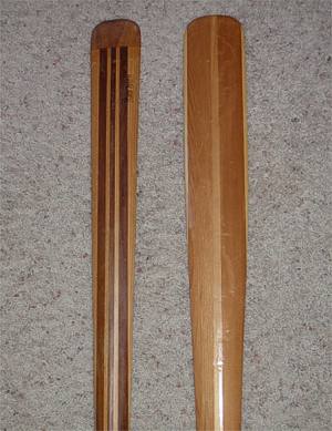

Don't Shy Away from Greenland Paddles
It is also important to note that just because the Greenland paddle was 4 tenths mph slower than the wing paddle, it doesn't mean it is a slow paddle. Remember, I was comparing racing speeds. Since the common average touring speed for most sea kayakers is 3.5 to 4.5 mph, anyone using a Greenland paddle would have no difficulty in paddling with the group or even sprinting ahead.
Since all Greenland paddles are not the same, I also had a wider Greenland paddle made for me. The wider Greenland paddle (4" wide) increased my Greenland paddle time by 1 tenth mph. However, it definitely added more stress and I had to work harder.

If you don't want to make the transition to a Greenland paddle and you want to decrease stress on your joints you can also do it by paddling with a euro-paddle with a narrow blade. Over the years I have heard from paddlers that using a blade that was narrower than their standard paddle felt easier on their body. If you adopt the two-paddle philosophy I mentioned earlier you could carry a 2nd paddle that has a narrower blade. In the event your body starts feeling achy during the paddle that narrower blade may help. Most professional guides bring one or two narrow blade paddles as extras in case of overuse problems during trips. Again, if you change the propeller you can change the resistance.
