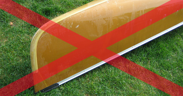

If you want to reduce the value of your canoe by about 200 dollars, put a thick, ugly skid plate on each end! Here’s why you don’t want skid plates!
- They add two or more pounds to a canoe--that’s weight you’ll have carry! Worse, the weight is added to the extreme ends of the canoe, which affects its "swing" weight or ability to gracefully carve turns. The flywheel effect of this is most pronounced in lightweight solo canoes where the paddler is located at the center. But accomplished paddlers in high-performance tandem canoes will notice it too.
- You can't sand Kevlar (it frizzes into string) so the harsh edges of the thick felt pads won't fair in to match the smooth contours of the hull. The result is increased wetted surface which slows the canoe and produces an audible gurgling noise.
- Skid plates are (choose an expletive!) UGLY!

Internal: invisible, under the first layer of cloth, does not effect the waterline; quiet. Knowledgeable paddlers—who care about beauty and performance—choose these.
External: The standard skid plate kit sold in catalogs and on line:, thick, ugly and noisy-- gurgles annoyingly as the canoe moves through water.
