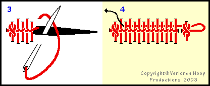

Start your stitch in sound fabric some distance away from the tear. Push the needle down through the cloth, then bring it up again. Line up the first entry hole with the long axis of the tear. Exit above. (Remember to leave a "tail" of thread. This tail will be oversewn to protect against unraveling.) Next, push the needle through the cloth below the first entry hole and bring it up to the left. Confused? Look at Step #1 in the sketch again. Now pull the thread tight. Don't pucker the cloth, though. The stitch should lie flat and smooth.
Warning! Here comes the tricky bit. Make a clove hitch like the one shown in Step #2. If it looks like a figure-eight when you've finished, congratulations! If not, try again. Begin by working the needle under the original loop stitch from right to left. Next, bring the thread down and across, moving diagonally over the top of the loop. Then push the needle under the loop from right to left again and reverse direction once more, sliding the needle under the diagonal stitch, but above the original loop. Pull tight—but not too tight. Got a figure-eight? Great!
Once you've anchored your stitch with a clove hitch, work your way toward the tear. Here's how:
Push the needle down through the cloth in line with the axis of the tear, bringing it up to the right of the first stitch. Then carry the loop of the new stitch below the axis, push the needle in, and bring it back through on the axis, just to the left of the new loop. Now cross over the loop and begin again. Stagger the loops: short-long-short-long…. Once you reach the tear, pass the needle through the rent. (See Step #3, above.) And as you sew, draw each loop snug. Not too snug, though! You want to bring the edges of the tear together smoothly, without wrinkles or puckers. When you've completely closed the tear, continue the line of stitches in sound fabric. Finish up with a final stitch and a second clove hitch (Give yourself a little room to make the hitch. See Step #4). Lastly, work the thread under the upper limbs of the long stitches, returning the way you came. Snip off any excess thread. You're done!
