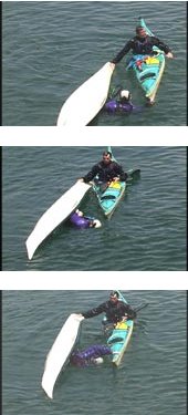

While paddler number two keeps the kayaks together, the first paddler performs a wet re-entry into their kayak. Remember to get yourself completely into your kayak with your feet on the foot pegs, thighs under the braces and your backside onto your seat.
When ready, reach for the overturned bow of your partner's kayak and use it as a support to right yourself. You will use less energy if you have your head come up last by using your knees and hips to right your kayak first and let your body follow.

After the paddles are transferred to the first paddler, who is now upright and holding the other kayak, the second paddler can begin their wet re-entry. When they are seated properly in their cockpit (upside-down) they reach for the upright bow of their partner's kayak. Again, be careful in rough seas.
The second paddler rights his or her self, using efficient righting techniques. Grabbing the bow is only one of a few variations. The second paddler could have kept their paddle and once in their kayak use the paddle as a bridge between the kayaks and roll upright.

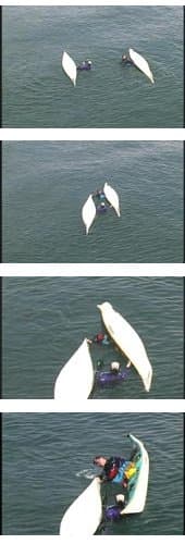

I also mentioned that both swimmers could do their wet re-entry and Eskimo Recovery simultaneously. They would each keep their paddles between the kayaks and retrieve them when upright. It takes some practice to do it at the same time, but it does work. The key is to support yourself on your partner's kayak while allowing the kayak to roll under your hands.
This can also be done simultaneously, if both paddlers used a paddle bridge to roll up as done in the Eskimo Paddle Recovery. Since the kayaks are rolling under the paddles, there would be little resistance from the other paddler.
