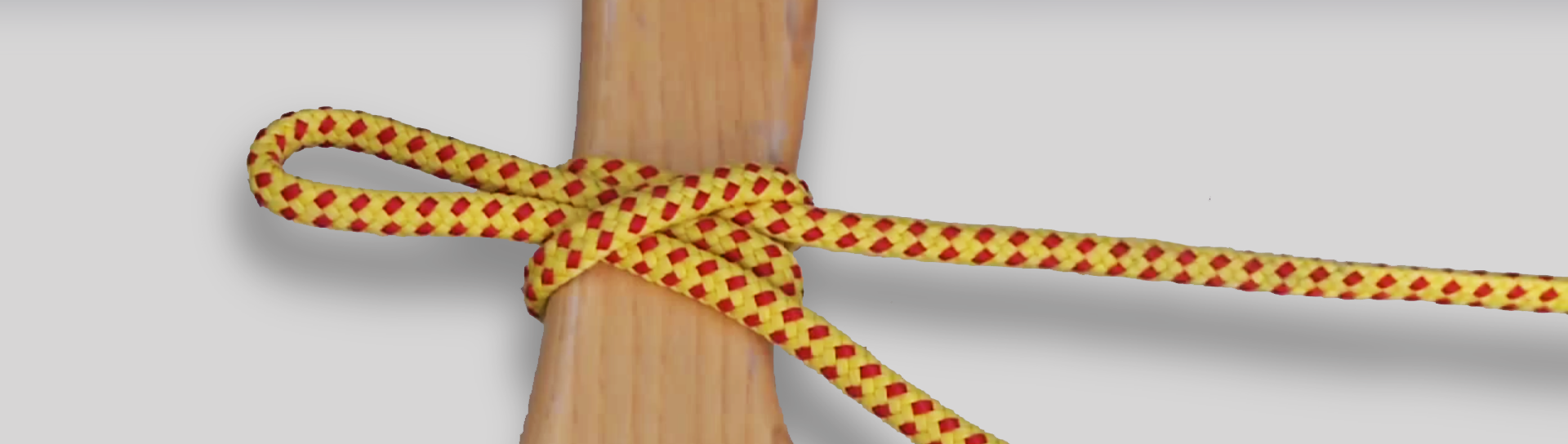

Highwayman's Hitch
Highwayman's Hitch
So the first one we've got then is the highwayman's hitch. When we pull the loose end we can see it all just jumps off. So to tie it, it's based on three loops. The first loop is going underneath, and then taking the long end, we create a second loop over the top of the thwart and through the first, and to create a third loop we use the little end now and it's going to come again over the top and it's also going to go through the next loop. Then pull the system tight on the knots so it's nice and down. Pull a little on the end and it all jumps off.

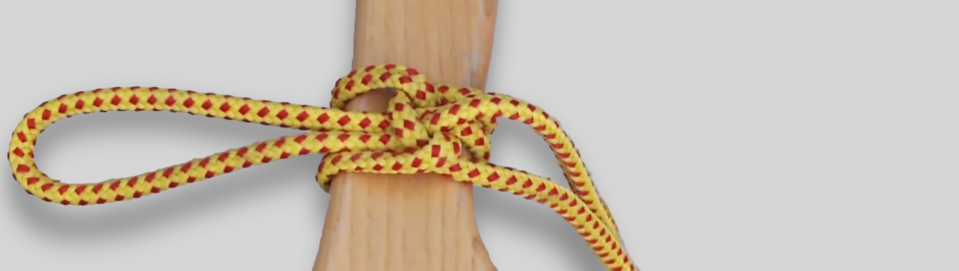

Clove Hitch on a Bite
Having a second knot that we can tie when the ropes on the tension is often quite useful so the one we've got here is the Clove Hitch on a bite. So if we pull the little end it comes off, but it does require tension on the other one to release it. So to tie it, we create a cross over there and then as it comes up, we're going to put a loop or a bite of rope through and pull the whole system tight. At last we pull the little end but it does require tension for it to come all off.
